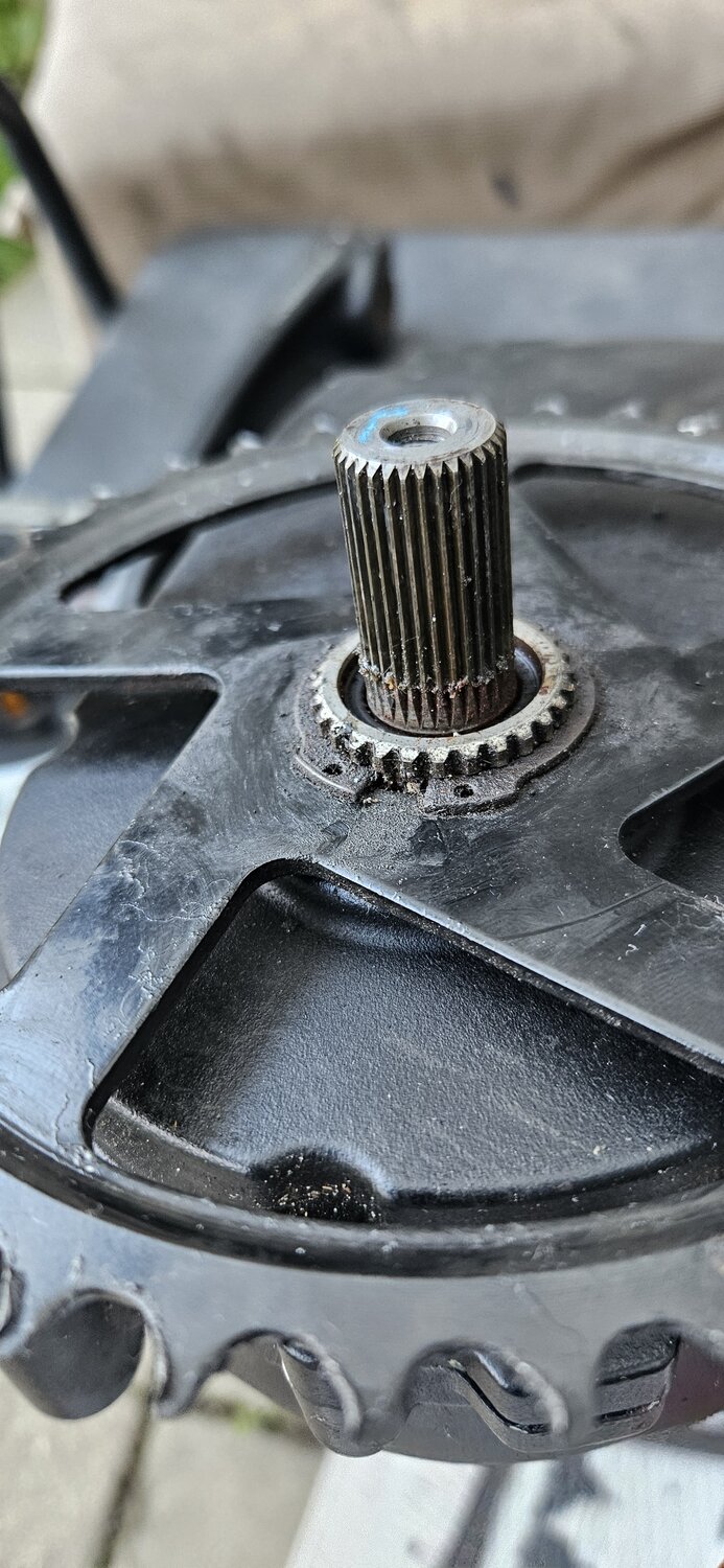

Gentlemen, how do I remove the chainring ?
MartsEbike Well-Known Member Region United Kingdom City Dunstable Yesterday at 1:40 PM #2 Looks like you need external circlip pliers to remove the circlip... You can buy them cheaply online. The chainring should then pull off.

E Extreme1 Active Member Yesterday at 8:21 PM #4 A small screwdriver can be used to pry out and up on the circlip. Then work it around and off the toothed shaft. Circlip pliers are the best, but if you don’t have any…
