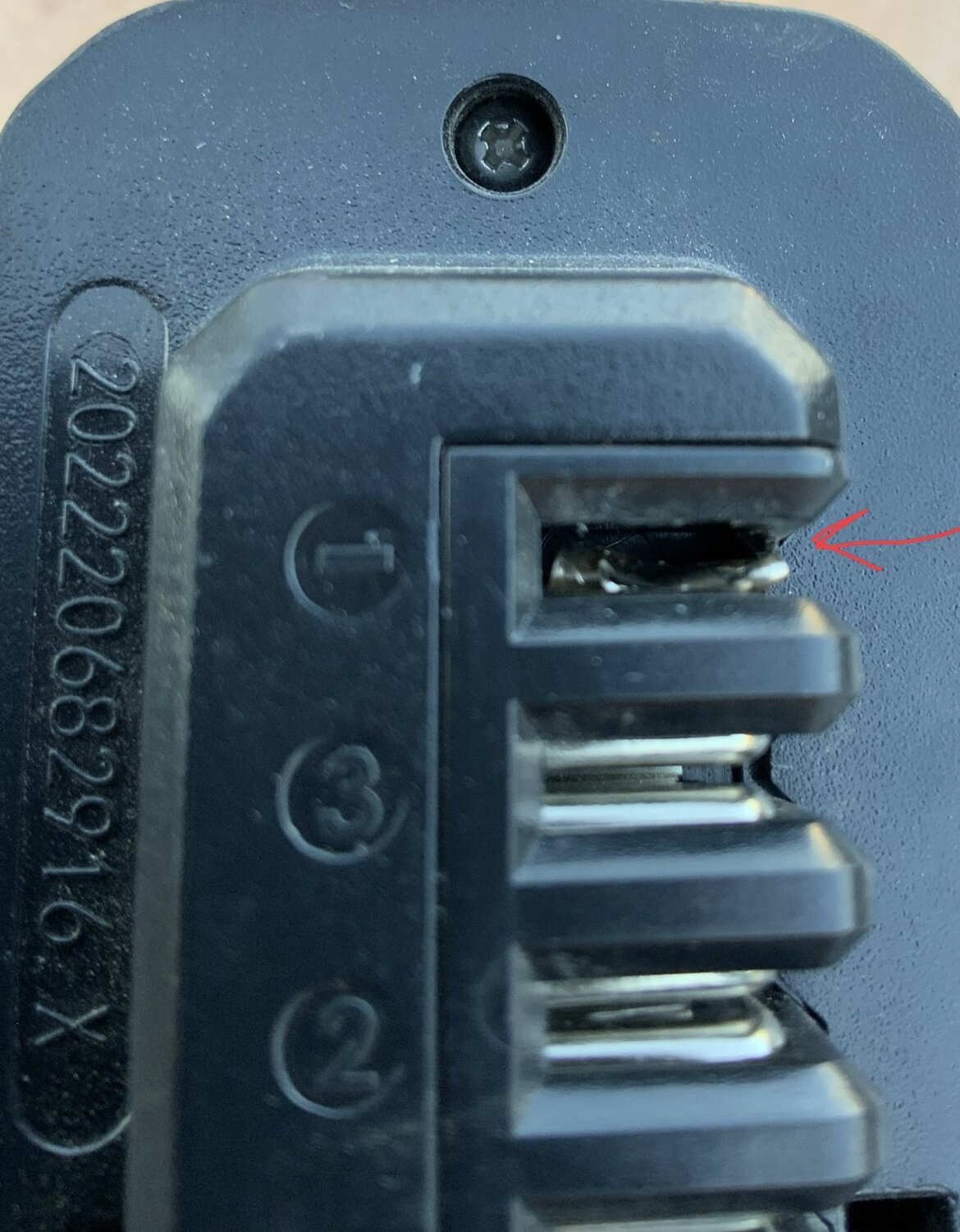

On the battery itself one of the Female pins is bent. (Making the battery pretty non functional)
what are my options for repairing/replacing the pin, or is there an option to replace the top of the battery containing those connectors?

Doesn't the Lectric battery use an on.off switch? Verify it works, then you can work on the connector.
These connectors are almost always OEM parts for battery cases. If you can identify it on the sellers page, buy it.
The battery itself doesn't have an On/Off. There is a key that turns off the power on the battery itself but it is part of the assembly L Weaver is replacing.
Battery connector is replaced, works great. lectric had a 30 amp fuse that I needed to add (it’s an extended battery, not sure if that is why). Thanks for all the help.
