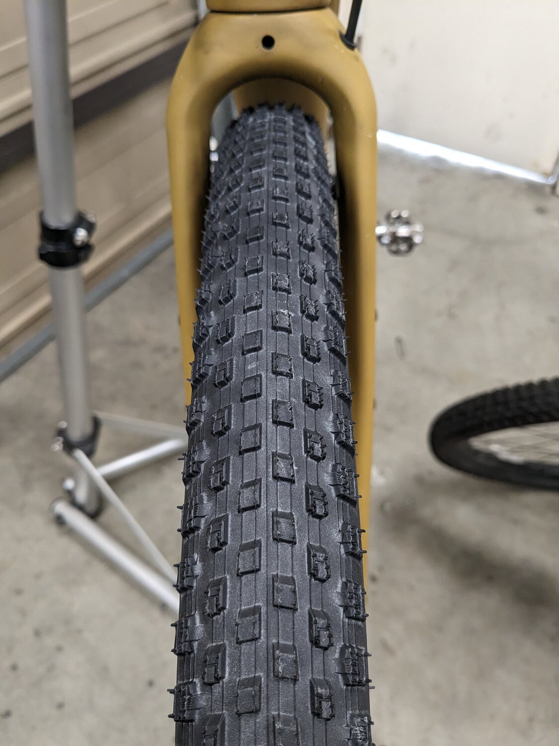

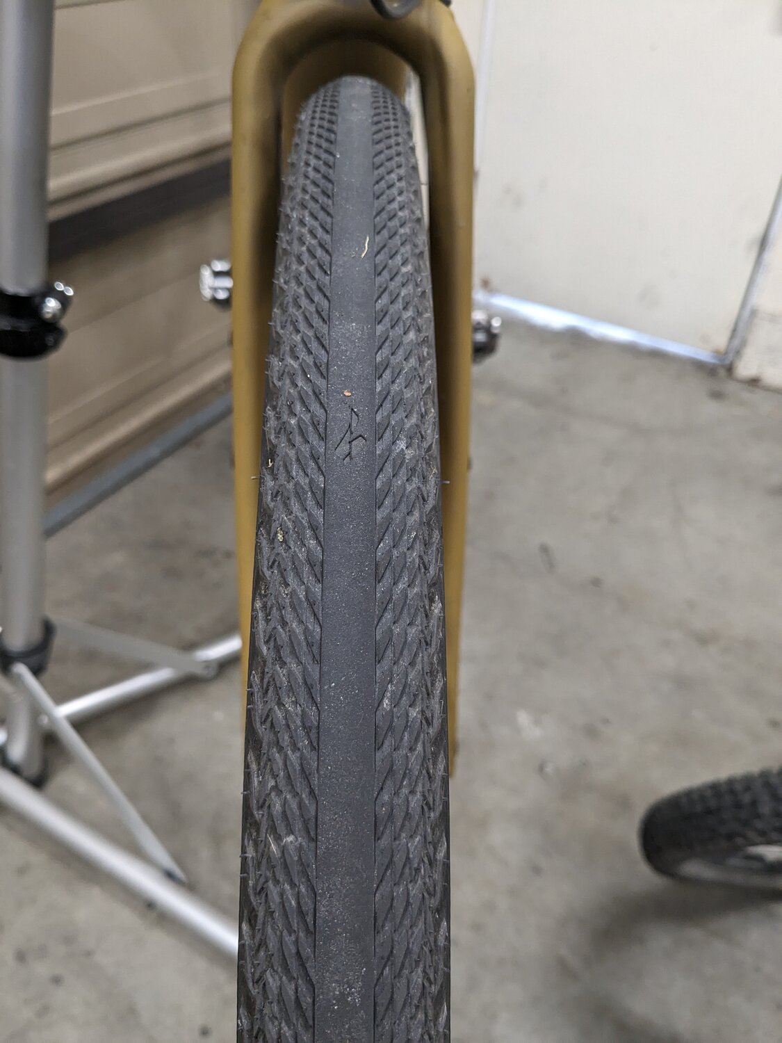

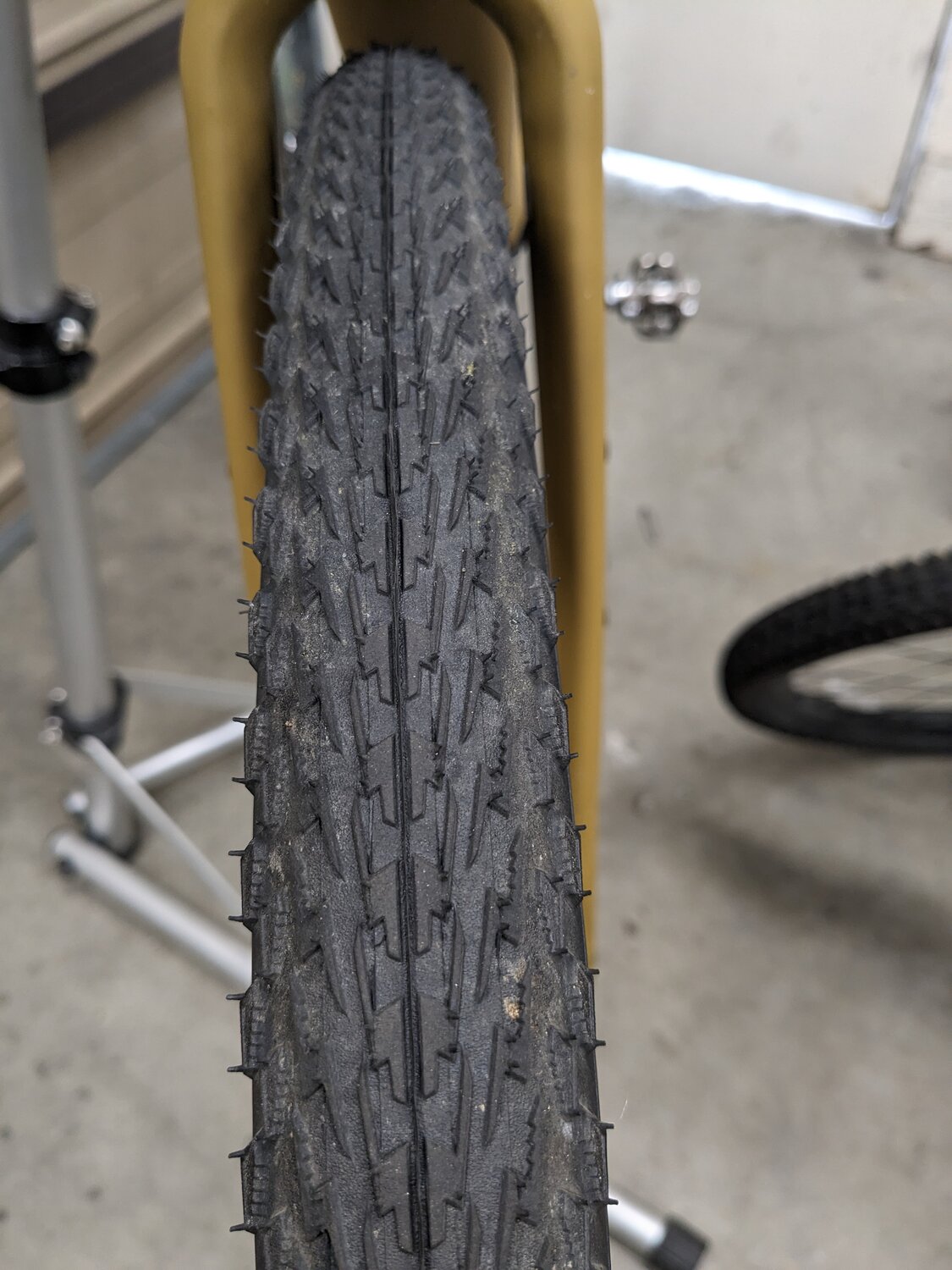

Here are a couple photos comparing the stock 47mm Tracers, 42 mm Pathfinders and just for fun 55 mm Renegades.
