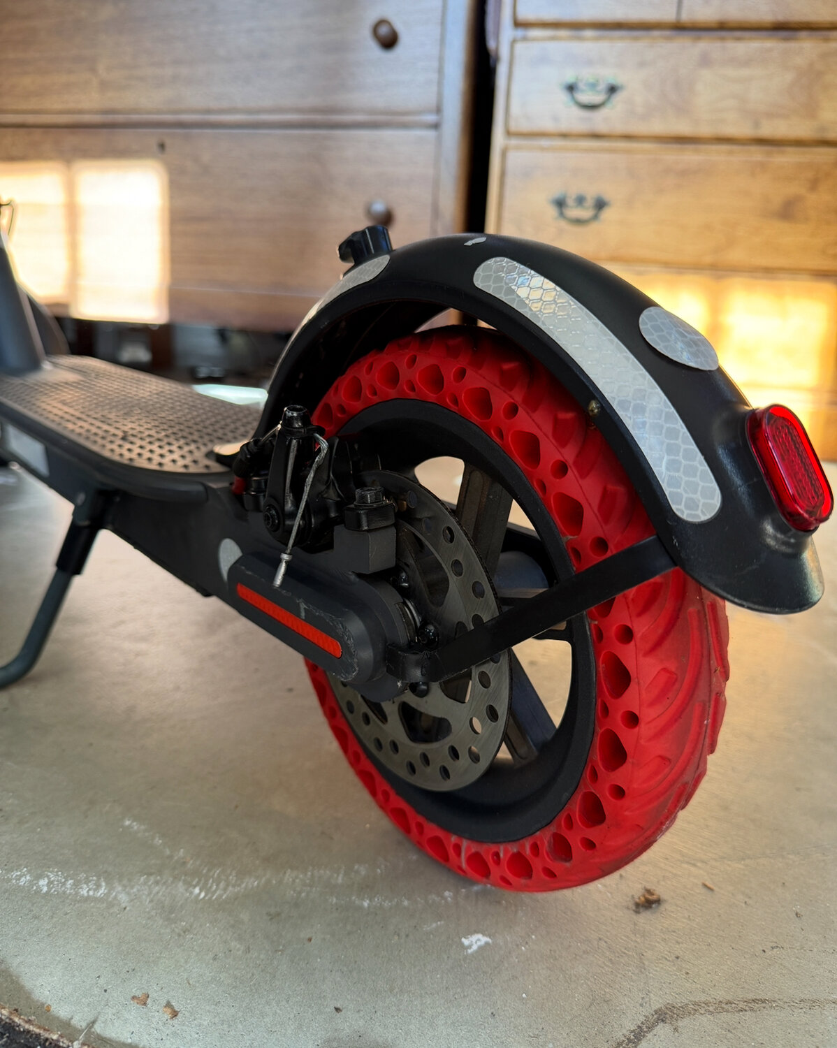

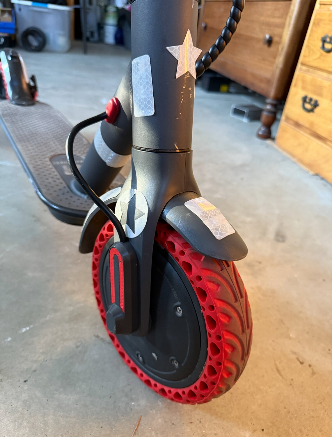

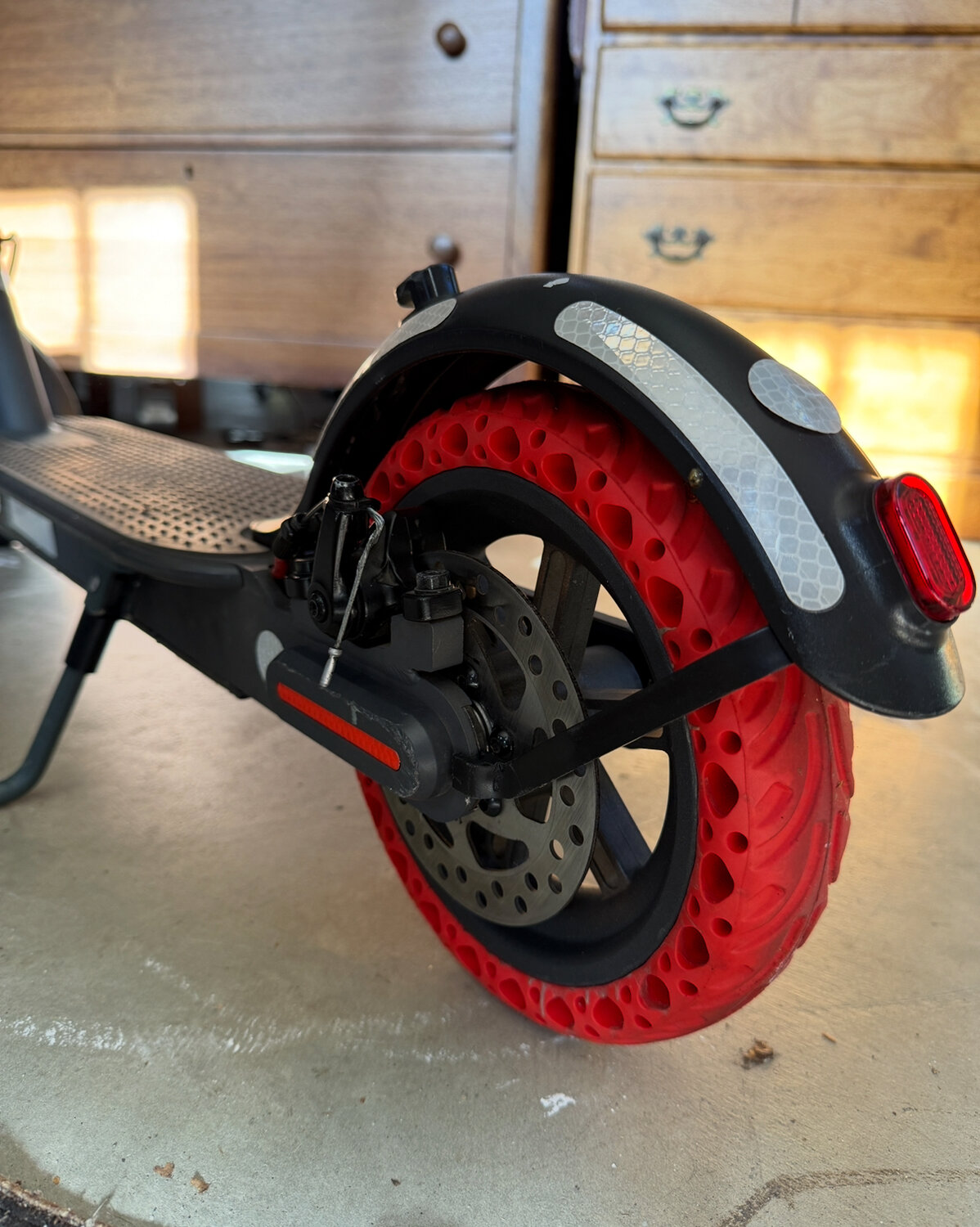

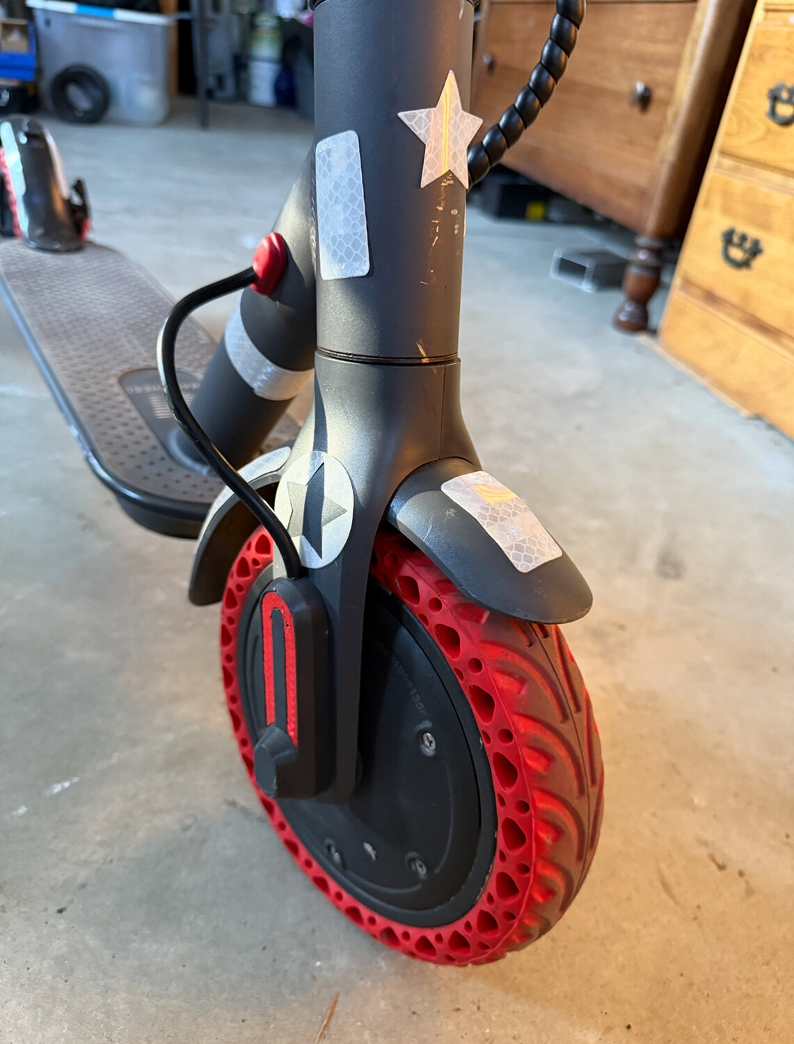

On a macwheel mx1, the wheel is solid. However it is really regular tire without the tube. The tire is filled with foam. It was a bitch getting the tire off the wheel. I ended up cutting the wheel off. I used a hacksaw (legit bike tool) to cut the meat of the tire. Then I used wire cutters to cut the steel off side the head of the tire. There were multiple steel strands. Tires were off in about 15-20 minutes. I then used a heat gun to eat the new solid tire. I was not changing the scooter wheel in the kitchen, so I used garage tools. I heated each tire for about 20-30 minutes. With the help of this and dish soap I was able to slip the new tires on. They went on crooked with only one side fitting in the rim. I then used a long, thick, screwdriver to pull newer into the honeycomb wheel and “pulled” the tire towards me. The tire was now popping into place. I was then able to insert the flat head of the tire lever and slid it around and the tire. This seated the tire in to place. I didn’t take pics because I like to focus on working rather than stopping to snap a shot, but this did happen. Here are some after photos.
