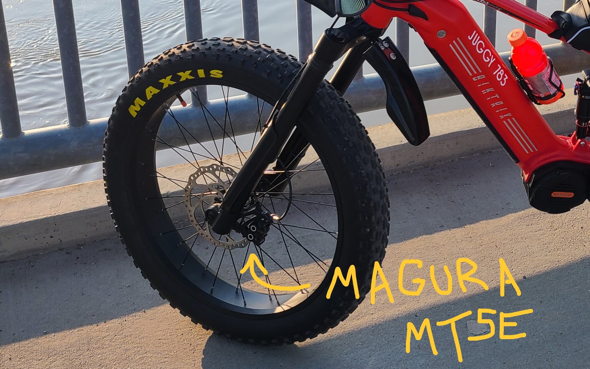

I hope your juggernaut braking is better now, megathumper!
My FS ultra pro 3 came with the optional magura mt5e brakes. Thus far they are braking well for me in the dry. It just rained here, so I might try some steeper downhills tonight in the wet to see if they fade at all
