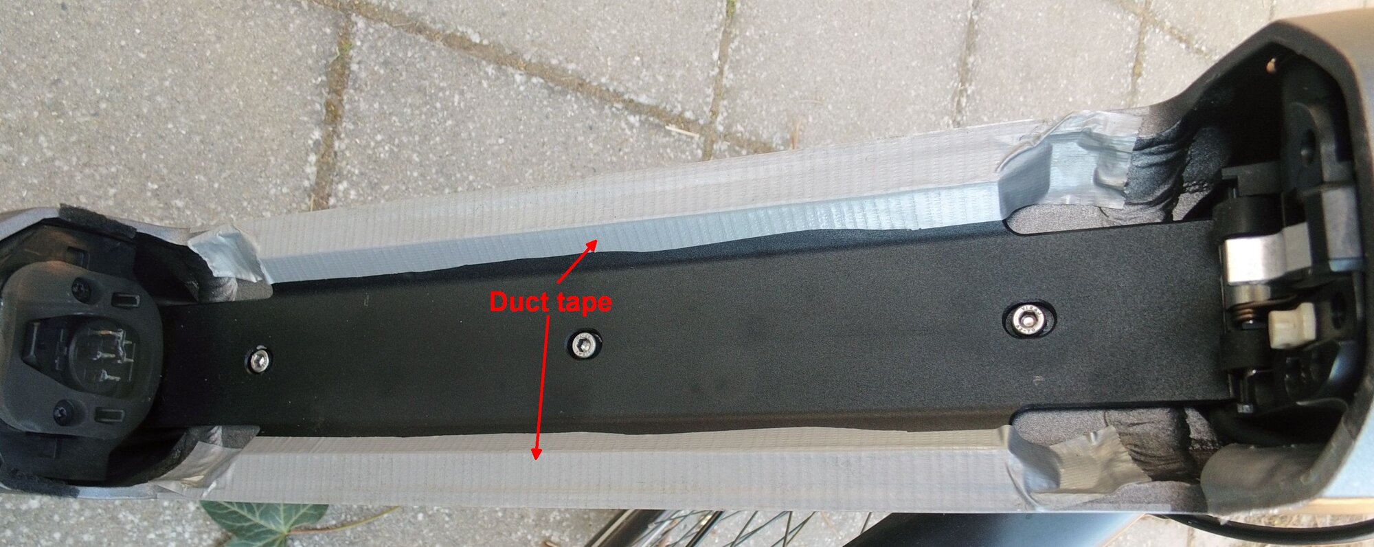

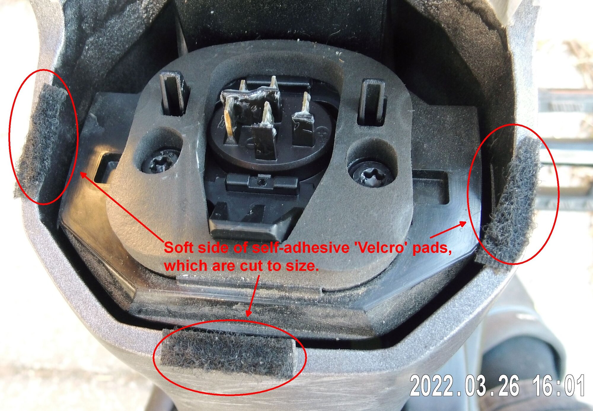

It may be the battery cover that rubs against the bike frame. It is a known phenomenon for the Ultimate C380 (perhaps also other Ultimate subtypes) and it has been discussed several times before in a Gazelle FaceBook group. I have also had that creaking sound myself, and removed it by putting some thin self-adhesive felt pads in the bottom and edge of the battery holder. I also put a thin strip of duct tape along the edge all the way around.
It is also possible to temporarily stop or reduce the sound by spraying thin silicone oil along the edge of the plastic sheath that covers the battery itself.
In my opinion, it is a design flaw in the battery cover that Gazelle should correct.
I enclose two photos that I used in the FB debate earlier this year.
Perfect! Looks simple enough. It feels like the major creaks are lower but it's hard to tell and the frame can transmit the sound and vibrations easily.
