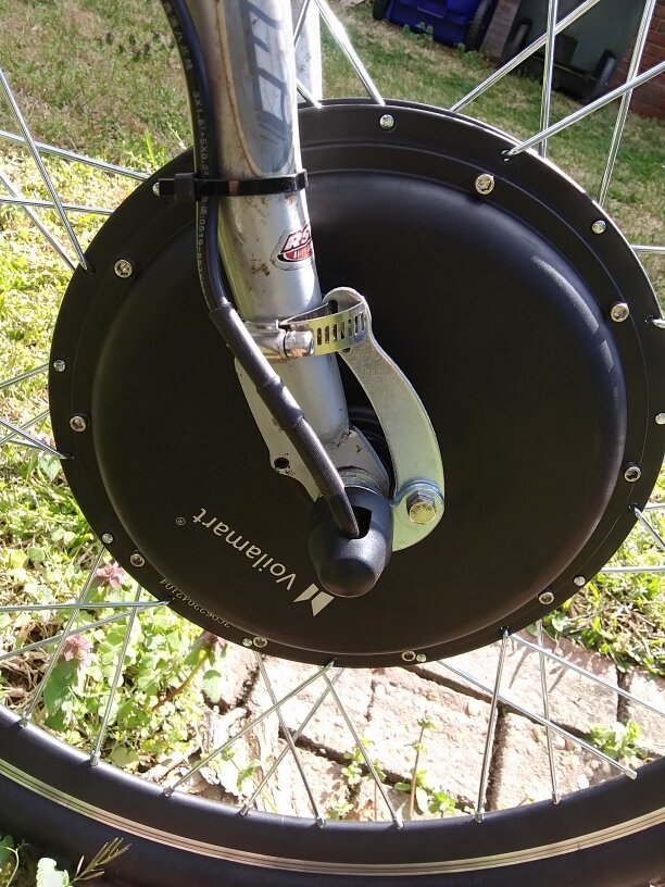

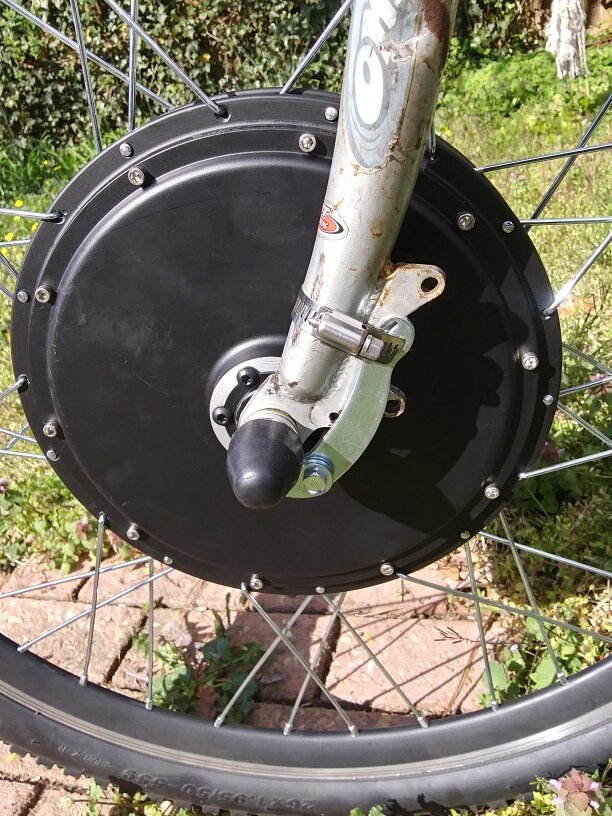

Can we see a photo? Of each side of the front fork? There are potential safety pitfalls that maybe some builders on EBR can discuss. I love BSO.
Front torque arms config. Took my time to ensure it was a solid fit and very tight. Seems stable.

Thanks for the photos. I will let others take the lead. I ask because we have seen bent forks with front hub motors with similar torque. So, it has a front rim brake?
Yepper... I know most will disapprove but I'm not trying to work it hard. Mainly a daily commute to work and occasional weekend pleasure ride on a beautiful day.
