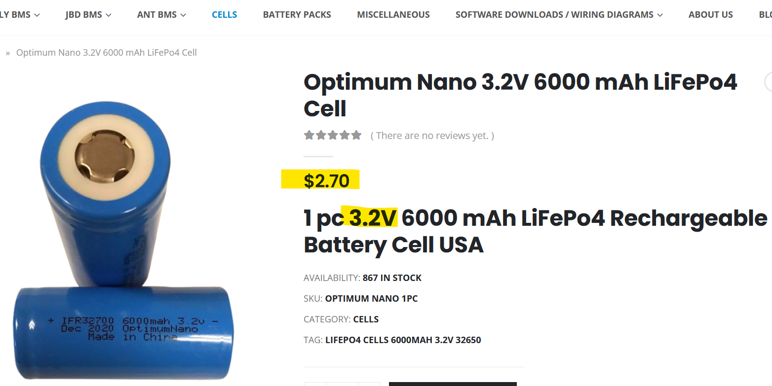

The best way to sell these LFP cells, the 32700 cells, would be to assemble them in modules. Micah Toll once had a crowdsource where he offered small modules of assembled cells, which could be soldered. He took a lot of heat and the idea died. If you simply took a machine spot welder and assembled these Nano cells into 16 series, you’d almost have an ebike battery, but a small one. If you put XT60 connectors on the modules, you could parallel them effortlessly. As far as balance leads or a BMS, I don’t know. A basic connector and an external BMS would be simple. Most batteries have protections from the charger and the controller. So, if you took two modules and paralleled them, you’d have a standard ebike battery.
Certainly this approach is open to criticism. It’s a CNC type welding process. It’s a safe cell that is rated for 2,000 cycles. I’d like to see the issues, but I don’t see anything that is a real business because it’s something anyone can do. I would note that the $2.70 per cell is US retail. I mean, if you go buy a few thousand in China, it could be quite a bit lower.
Battery Hookup is essentially doing this with a 32700, but he’s assembling 20 in parallel, a little brick with a lot of amp hours and low voltage. But he sells them in sets of 4 which makes a standard 12v battery, like for an RV cabin deep cycle.
Something is going to break the death grip of US ebike companies on the pack market. This is essentially a ‘hundred dollar’ pack that offers advantages at the price of bulk. For an ebike for people with limited incomes, it probably works. It’s not really a hipster pack.

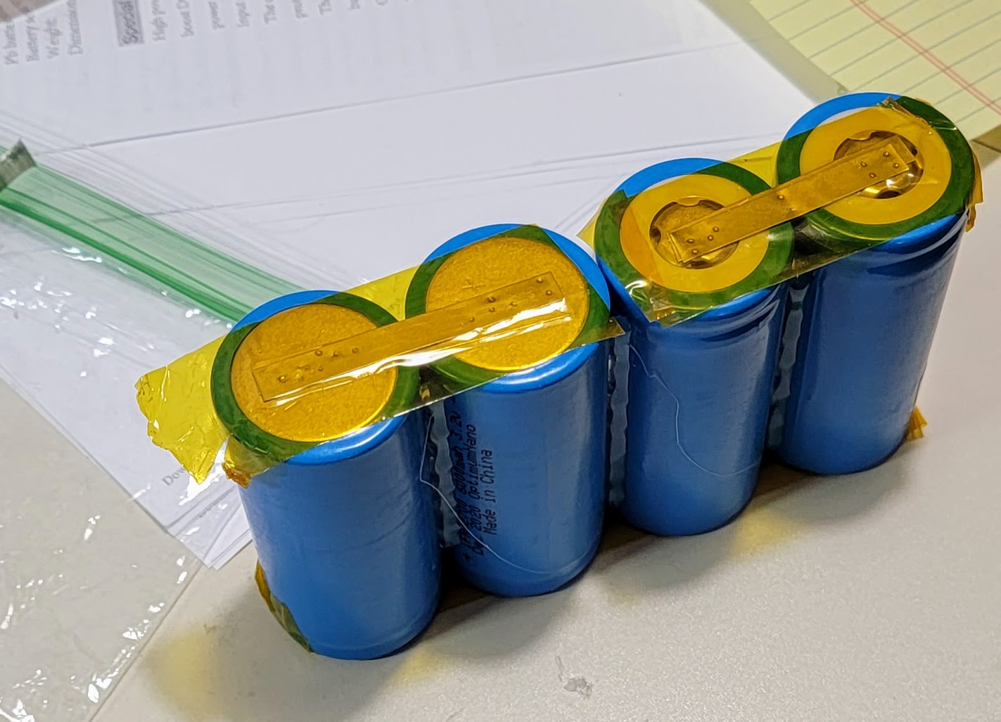

Right now, there is not much interest in welding
I’m not understanding where you’re getting this idea. There are significant sales in welders and components. JP or Jakov started the small welder market and it lead to several good welders far superior to Sunnko(thieves). Several long multi year threads around. And likewise Several Facebook pages. Banggood now sells a battery powered version that is handy for small projects. But I’d never promote or suggest most eBikrs owners jump in. The water can be scalding. The cheap seat China makers CAN build a battery to customers specifications meeting all of Harry S posted standards. Not inexpensive, but decent quality and long service use.
If you want a single pack, maybe to just build an ebike, I'm not sure building is cost effective. There is a learning curve. Micah Toll has good videos and a good book. Tom at Battery Hookup has those 20p modules of the 32700 cells. I assume he gets them from a jobber, but he might own an automated welder. I've looked at the welders, the big ones that can weld packs. They are fast, and they don't add much to the cost of a pack if someone is using them steadily. If you machine weld the packs, you can probably get quality welds and then you can use the nicer nickel overlays. Someone who wants to do this as a business might want to invest in the welder, and they would definitely want a good source for the cells in China. The Chinese still seem to appreciate people who can provide steady contracts with big numbers.
I built 2 packs with a Bangood welder. It's a nice enough welder, portable, with a foot switch. There are some welding patterns that are clearer, as you assemble. You can take 4 cells, two up and two down. Weld across all the cells and call that the bottom. Do the parallel on top, two different strips. Now you only connect each set to the next in one place and you are always on top, not flipping. I put the Kapton tape on everything as I assemble, so there aren't live connections. I have shorted out a module of LFP. It burned off the top, but that was it. It's a good skill to have, but you want to be careful. Try to use welding patterns that are obvious, and use a volt meter to see if two connections might be live.
