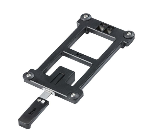

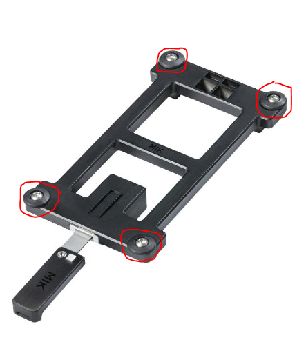

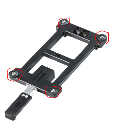

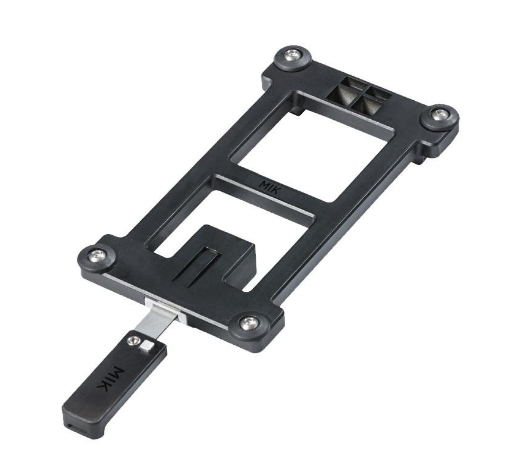

I'll try to get some photos when I get home but here is a general description.
Topeak Trunkbag Ex-Velcro (https://www.amazon.com/gp/product/B0186OQIEI/ref=ppx_yo_dt_b_search_asin_title?ie=UTF8&psc=1)
The MIK adapter plate (https://www.amazon.com/Basil-MIK-Adapter-Plate-Black/dp/B075DKV1MK)
1.Each corner is a screw & washer that screws into the base. Red circle is the piece that screws loose.
2. I took the screws out so I could mark the locations of the holes on the bottom of my Topeak bag. I taped the base in place and snapped it in to make sure I had it where I wanted it. The bottom is semi ridgid so that really helps to mark & then drill through it.
3. I took the bottom padding & taped it out of the way inside the Topeak bag (just a small piece that flips up. and drilled my marked holes (going from the outside to the inside)
4. Then place the screws/Washer pieces on the inside the bag, through the holes you just made, and attached to the base of the MIK plate. Tighten screws & you are done!
I was super nervous drilling holes in a brand new bag... but it worked out well.
View attachment 36373 View attachment 36374

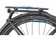

This is a MIK Rack top (it will look the same on each MIK rack, even though this is just a piece of one)
The red circle is where the nose of the adapter will slide into/under and then the blue circle is where the adapter will clip on.
This is the little "key" that you use to unlock the bag from the rack.
It does fold down into just the black piece for carrying in your pocket or bag, or you can leave it installed in the adapter for easy removal.
Hopefully that is all clear as mud.
