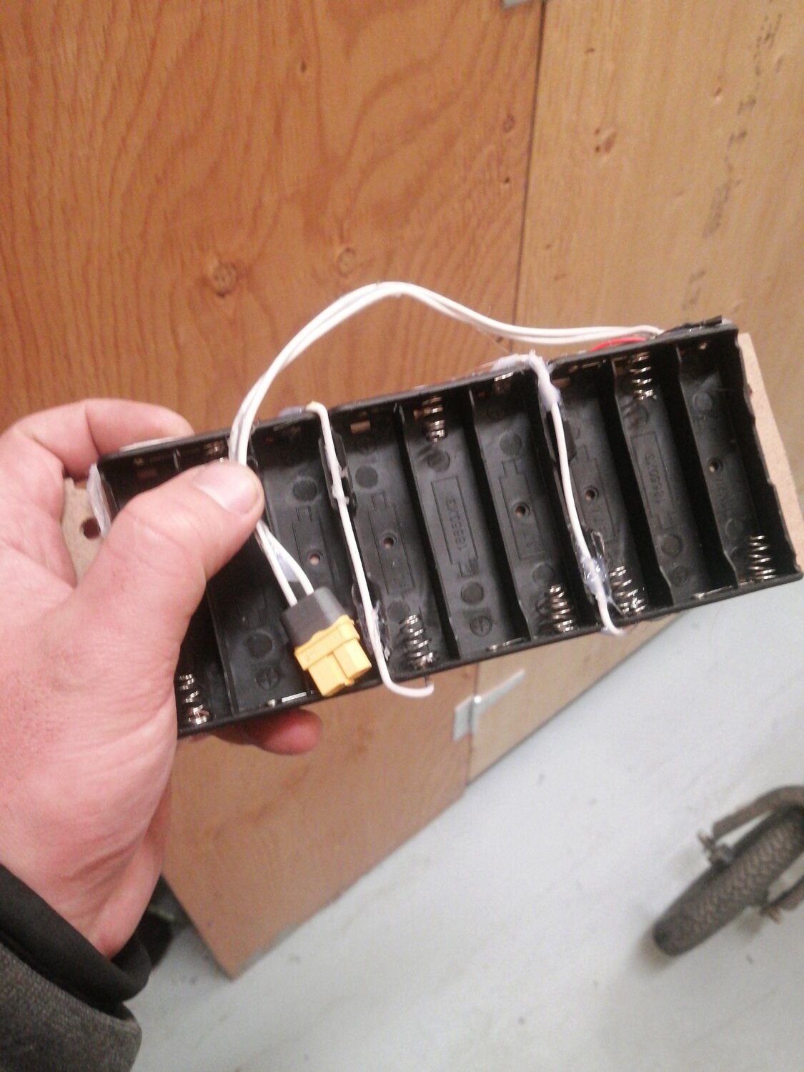

Will this work?
More specifically with batteries in it and even more specifically in a 36 volt electric bike. The batteries are Samsung ICR 26H M
It is wired in series and the white wire is 16 gaije copper.
Thanks in advance.

Buy all seriousness aside what will happen if I try to power a 350 watt ebike with this battery tray?
18650 cells have a high current discharge rate... There's a good reason you don't see your set up used.
So, your cells are rated at 2C, which equates to 5.2 amps. The 16 awg copper wire is marginal, but should "work" for that current, at least for a while. You show a 9S1P configuration. 9 cells in series should yield 9x3.7V = 33.3V "nominal", but when fully charged, they will briefly yield 9x4.2V = 37.8V. Li-Ion discharge curves being what they are, most of the discharge life will be closer to the nominal voltage. Most 36V ebike battery packs are 10S, I believe.
I think the real question is, will this work for what? They won't propel a 36V ebike for long. If you want them to stay balanced, you'll need a battery management system (BMS) to keep the cell levels even, unless you have a low-voltage parallel charging scheme. So, what is the mission of your 36V ebike?

The BMS hooks up to each parallel set of cells in the serial array. in your case, since you have a 9S1P array, it would need 10 connections (across each stage of the 9S array - it looks at every cell in the array). It monitors and balances voltages among the sets when charging (so that one set doesn't get over or undercharged), and it monitors voltages during discharge to avoid over-discharge. Typically, it can shut off the discharge when the voltage drops too low.
There is a reason that e-bike battery cells use soldered or spot welded nickel ribbon to carry the high current load. As mentioned by @harryS above, the gauge of the wire in the springs isn't heavy enough. They are also made from a steel alloy which isn't the best conductor. They will heat up under high current and lose their tension. That will compromise battery contact causing more heat. IMO, It's a fire waiting to happen.

The bike did not go very fast
Also the cells dropped from 4.14v to 3.99 in maybe 200 meters
