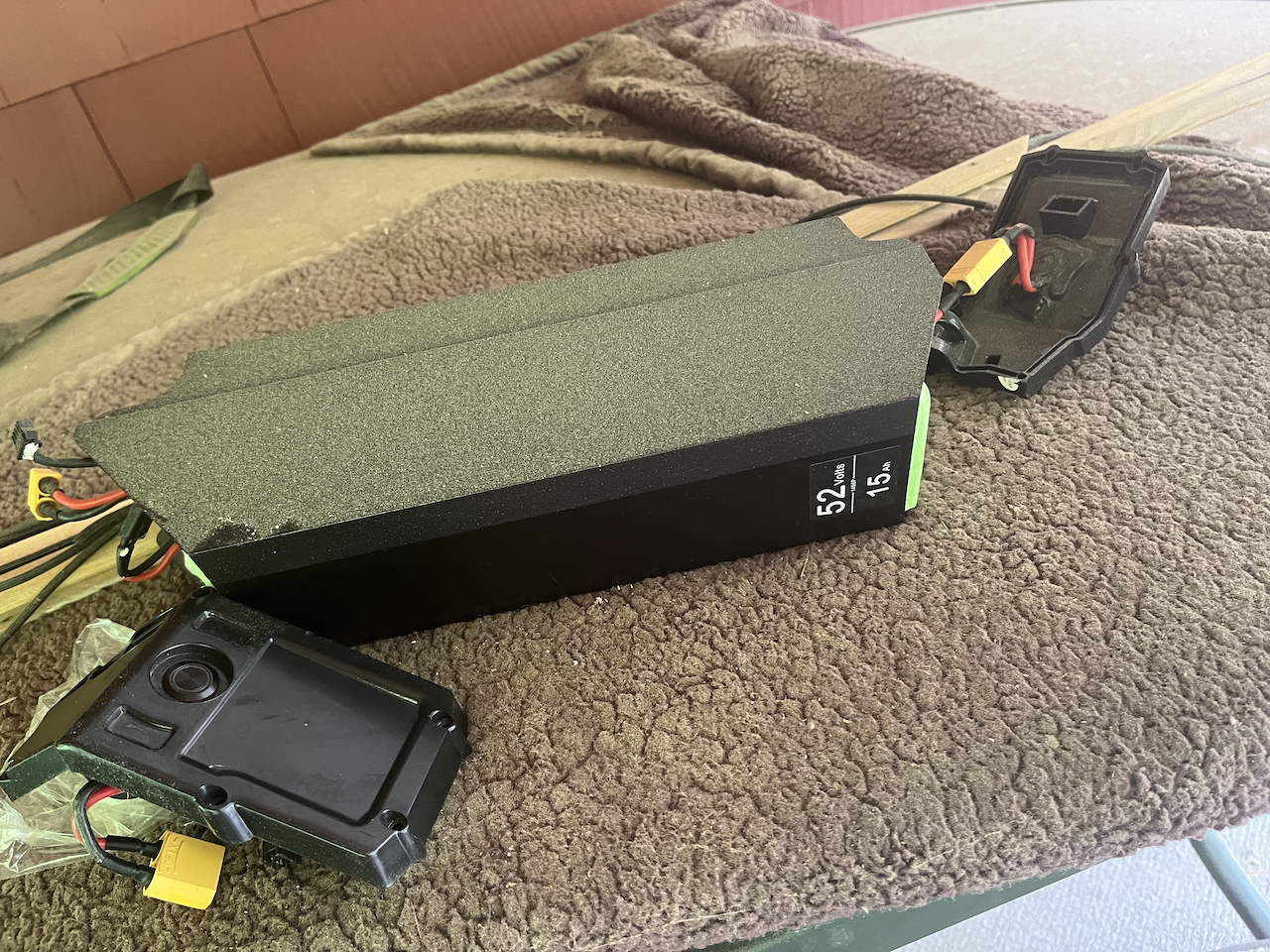

I’d love to help you, @Airship , but what I did was to try to run a used, older battery on the newer (2022) RipCurrent and that didn’t turn out well. This battery is labeled 52V/15Ah, as you can see in the photo below. This battery installed and ran OK on my bike for about 1/2-hour before it quit on me. I don’t know if the problem was some incompatibility or if there is something wrong with the battery. I have a theory that the on/off power switch is bad, but I have not found a replacement to try, and I have not found an easy way to remove sealant that they used around the wiring. Anyway, sorry.
I read in one of the manuals that there was supposed to be a 48V/52V setting somewhere in the menus, but there isn’t. At least not on the 2022 model. Even if what you try does work, I would guess that the battery charge indicator will be wrong since (I think) your bike had a 48V battery originally. I didn’t think the RipCurrect used those, though??

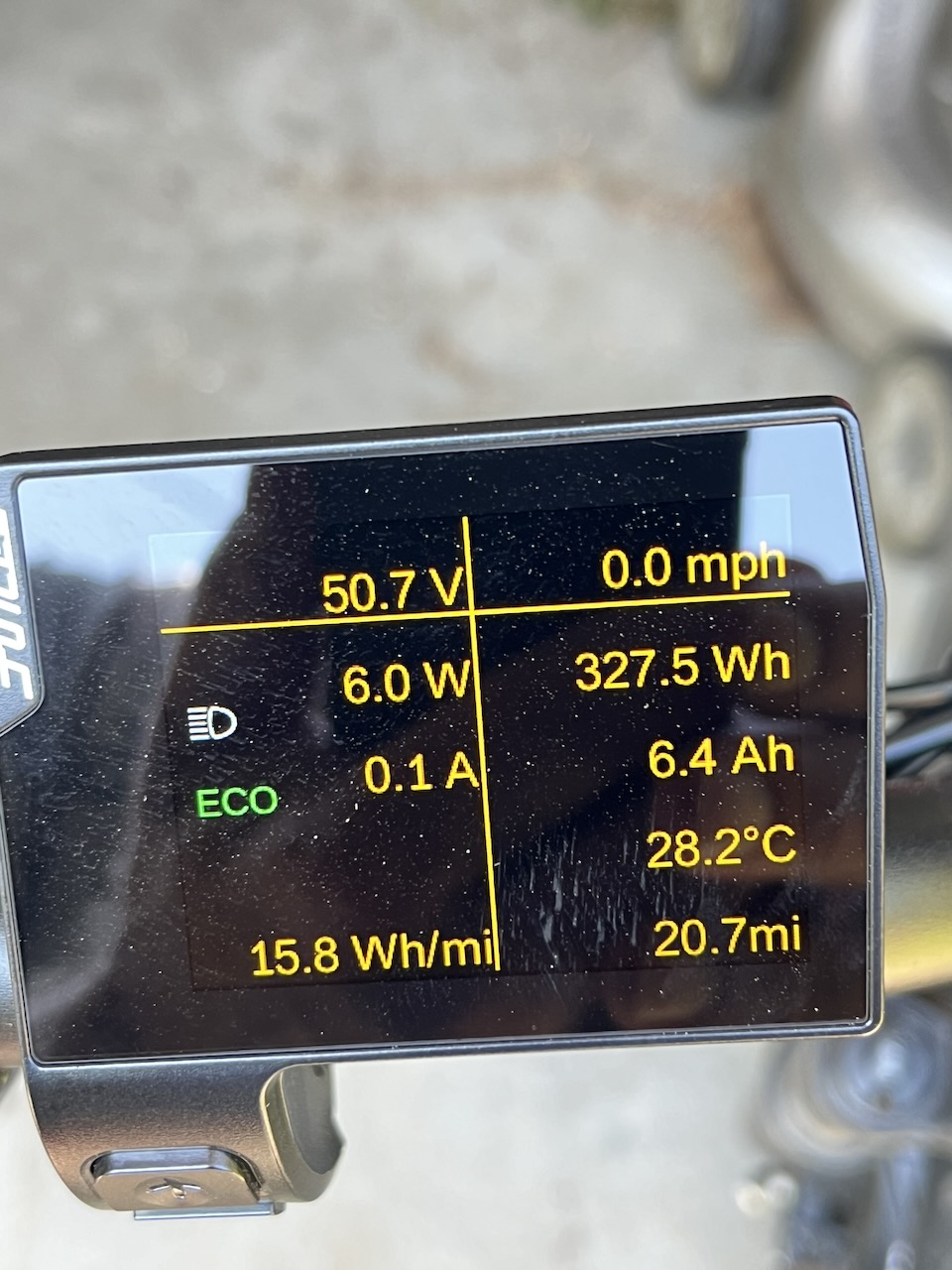

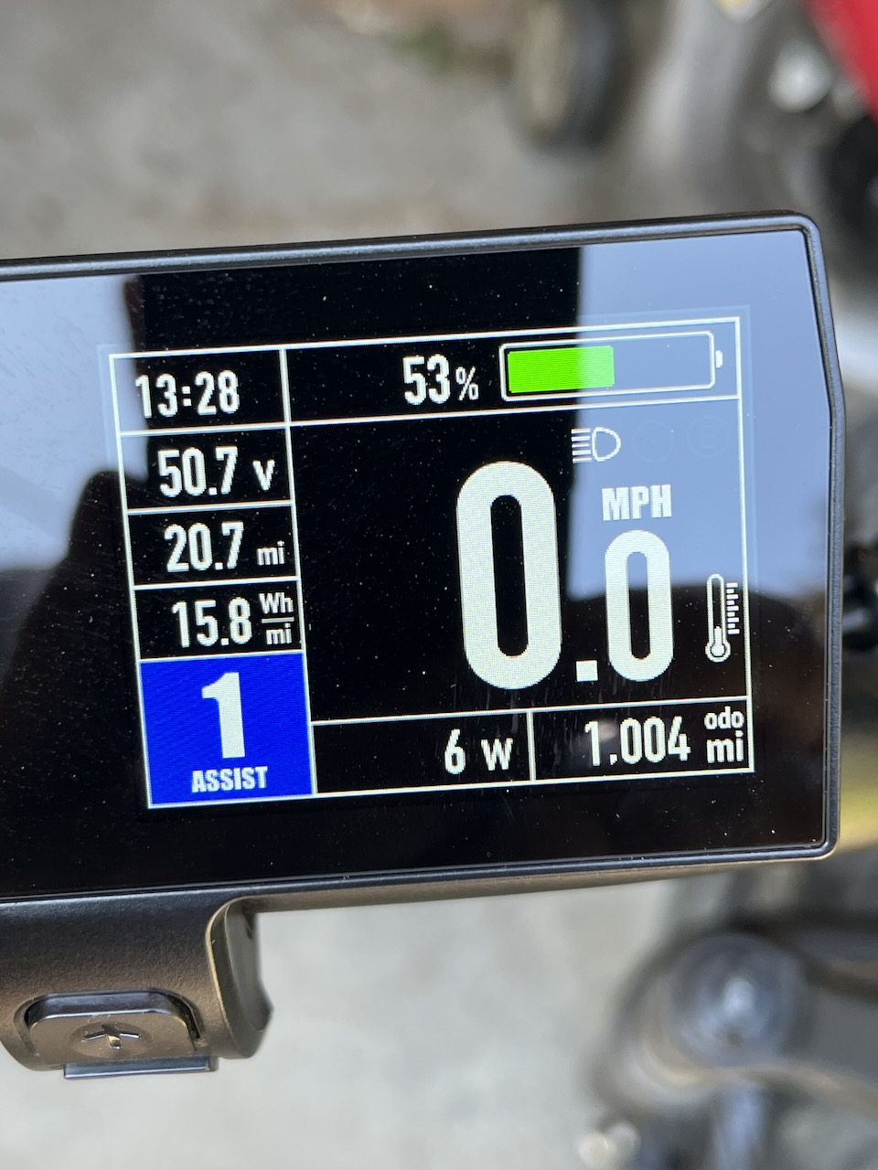

The new display works great other than the power surging on and off in Sport and Race mode. It doesn't do it at low speed and seems to only do it pedaling hard in 8th and 9th gear. It feels like the speed limiter is cutting in, even though I have the NDW mode set to 5 and the speed set to 62 MPH. Since my bike is a 2018 with the 48v controller and the old programing, I'm guessing that maybe the issue. It also could be the 48v battery and the display is designed to work with 52v.
I did a back-to-back comparison plugging in the original display and the bike returned to normal. Other than that, everything works great, it's full color and the display looks really nice compared to the original. It also includes a clock, and the numbers are all bigger so it's a big improvement. So, for right now I'm just living with it and waiting for Juiced Bikes to come back online and get more info.

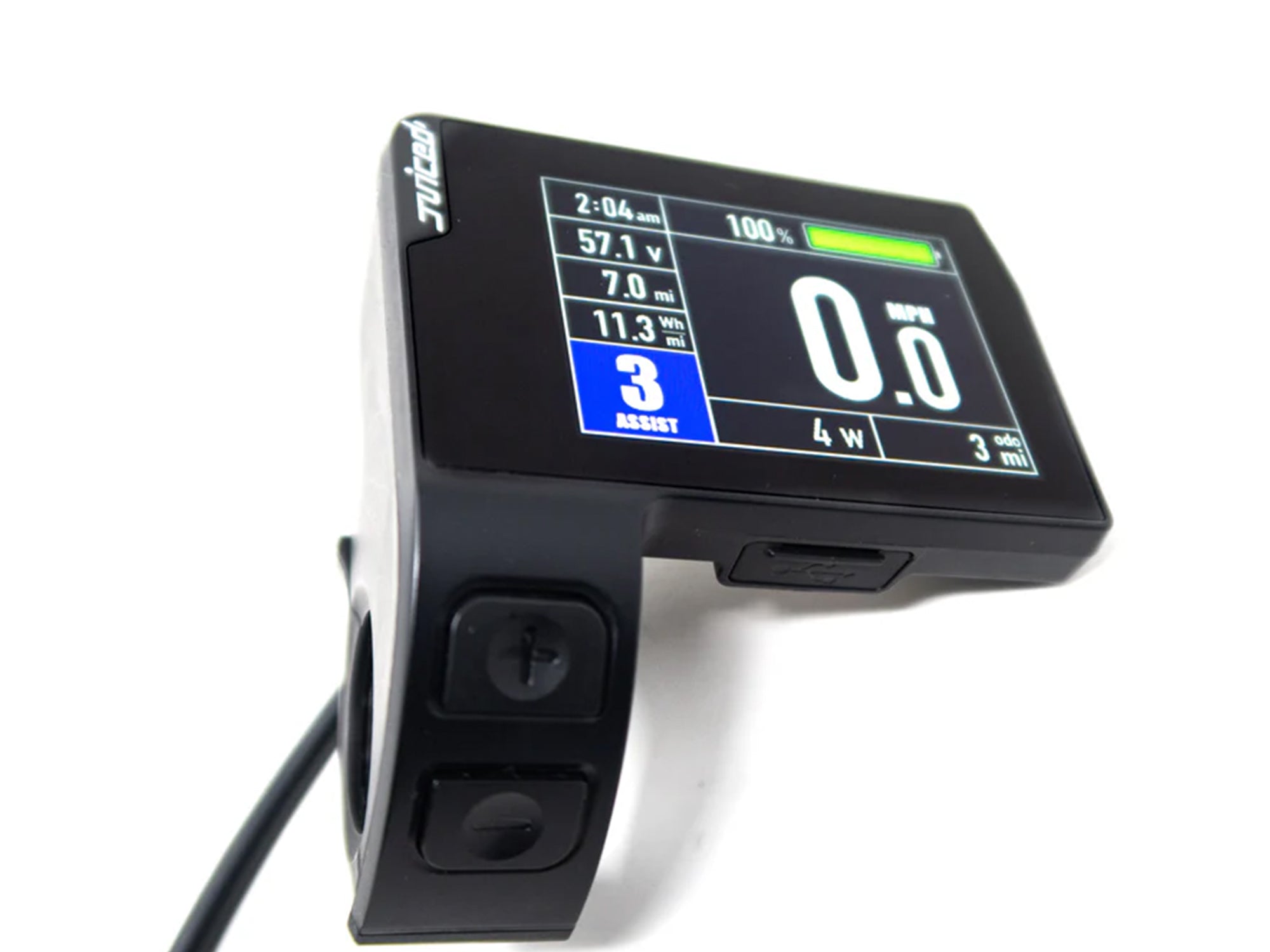

That’s great. I’m glad it’s (mostly) working for you. I was able to get Juiced’s final display before they shut down and it was a vast improvement which I am delighted with. The original was unreadable in New England winter, so I’m really glad I got the new one (see below).
But, the fact that the display is doing something different that affects your high assist modes seems strange to me. I assume you’re talking about the fact that you’re pedaling when the assist cuts out? If you’re not pedaling, well, I think that’s the way it’s supposed to behave, Airship. The speed limit setting is only for assist while pedaling. At least (I think) that’s what’s true for the 2022 RipCurrent model.

Yes, only while I'm pedaling, 8-9th gear in Sport or Race mode. On the throttle it works fine, 20 mph. It's definitely the display causing the problem. The original display works flawlessly. 0-3 assist works fine though, got to love electronics...

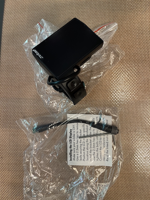

Hi, this new color display is still available, I bought one from Velowave and they have all the technical details listed. It shows it is not compatible with 48V bikes at all but it doesn't give detail as to why or what would happen if you tried to use it.
Hey, thanks for the tip on this, Cadstar. I grabbed it. It’ll be good to have a spare one of these in case mine gets damaged in the future. Comin’ up on 3000mi on my RCS! Oh, and I doubt this display would work with the old(er) 48V versions of the bike.
FYI, @Cadstar it arrived at my house today -- from Velowave, via SpeedX DGD (from JFK airport). A few days before they shipped it, they contacted me directly (email) to make sure it was the right part for my bike. Very considerate. I think it was originally shipped from China.

Glad I could help. Yeah they contacted me to double check order too - very considerate! I just picked up a used RipCurrent S and it's still rocking the original display, I'm ordering another color one for it too. They seem to have a good stock of them.
